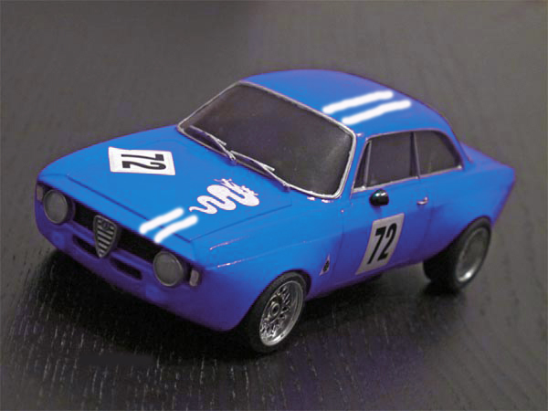

Autumn is the time for modeling!
This mould gave up after 15 bodies, and it's useless anymore!
The last body of this Alfa Romeo GTA 1300 mould should be something special!
Are there any suggestions?
L'automne est le moment pour la modélisation!
Ce moule a abandonné après 15 corps, et il est inutile plus!
Le dernier corps de cette Alfa Romeo GTA 1300 moule doit être quelque chose de spécial!
Y at-il des proposition?

Something like that? - interesting idea!
Quelque chose comme ça? - idée intéressante!
Alfa Romeo GTA 1300 Junior 'Gordini'

Sacrilège !! ! !
Une gordini restera une gordini ...c'est du renault pas Alfa !!

That is a long process!
First you have to find the right model, which wheelbase will fit. 1/24 scale is nearly perfect.
Just have a look for 1/24 plastic kits or 1/24 scale models like NOREV, Minichamps etc.
Assemble the body (plastic kits) or disassemble the scale models.
Recraft some details on the body like the fenders on the Alfa Romeo.
For the mould you need a 2 component silicon, Plasticine and LEGO.
Fill the body with the Plasticine, build a casting mould with LEGO, put the body in the LEGO mould
and fill the mould with the Silicon. After a while you remove the LEGO-walls and the Plasticine from the body.
Then put the mould upside down, build another LEGO wall and fill the mould and the body again with Silicon.
As soon as it is dry you got a 2 pieced mould.

Thank you TRF to reply so fast, and T.Y. twice for the link... finaly it's not so complicated!  Smile

Amazing work and passion on these 70's touring cars! congratulations for the achievements! cheers
